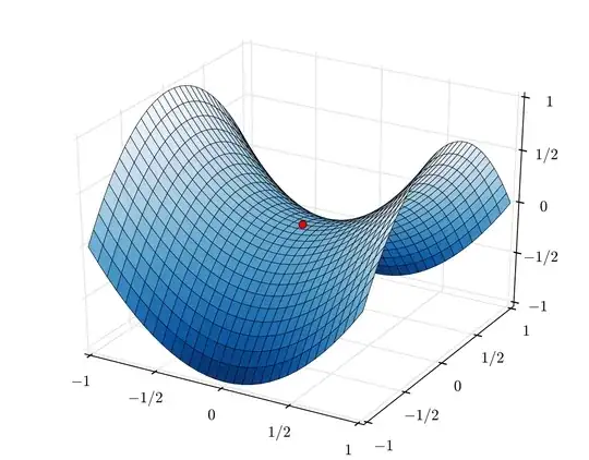

That's actually a necessary condition for well-behaved functions, but it's not sufficient.
Classical counterexample:
$$ f(x,y) = x^2 - y^2 $$
satisfies your condition in $(0,0)$ but it's not a maximum (nor minimum), it's a saddle point.
saddle point from Wikipedia, author: Nicoguaro
