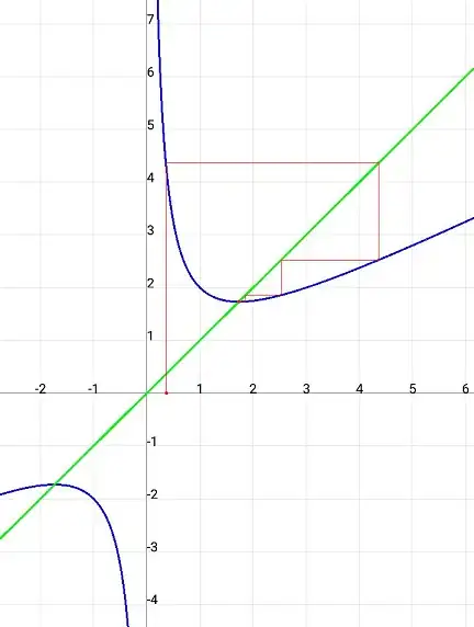

I find it easy to see why it works thinking about attractive fixed points. The sequence corresponds to iterating the function
$$ y = \frac{x}{2z}+\frac{z}{2} $$
and finding its fixed points means finding the intersections with $$ y=z $$
So, solving for $z$:
$$ z = \frac{x}{2z}+\frac{z}{2}\\ \frac{z}{2} = \frac{x}{2z}\\ z^2=x\\ z=\pm\sqrt x $$ If you choose a positive starting point, you'll land on the positive attractor. The closer your initial guess, the fewer steps you need to reach the target approximation level.
Here an example, with $x=3$ and a not-so-good initial guess:
Example with $x=3$
