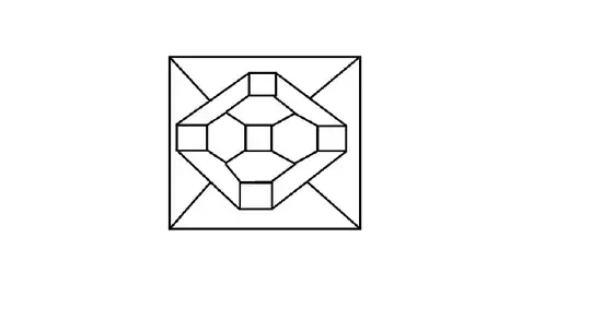

Planarity would guarantee a 3-edge coloring via the 4-color theorem. I checked the planar drawing below which I thought it should be the truncated octahedron and it didn't work. Reading further on Wikipedia:

EDIT Looks like I've taken the wrong graph enter image description here which is not the truncated octaeder, but a chamfered cube.

Every vertex must be in at least one square (since the red and yellow edges at the vertex must be part of a square), and it must be in exactly one square and two hexagons since you have specified that the squares are not adjacent.
So, we can build a cubic planar graph putting one square and two hexagons at each vertex; this forces us to make the graph of the truncated octahedron, so that's the only one.
