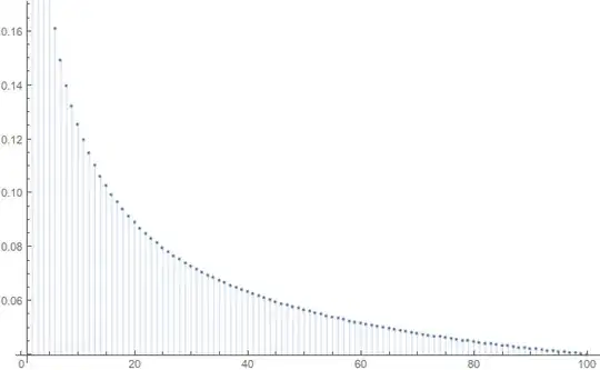

On Mathematica or Wolfram:
DiscretePlot[ n^n/(n! E^n), {n, 1, 100}][enter image description here]1
Then, once you have done that and gotten a sense of what you have to prove (here: the sequence, if anything, does look decreasing) you can attempt to prove it.
