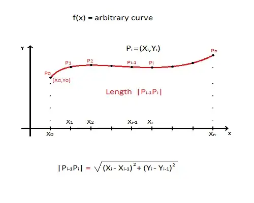

To calculate the length of a line we can use the Distance Formula or basically the Pythagorean Theorem: $$L = \sqrt{\left(x_2 - x_1\right)^2 + \left(y_2 - y_1\right)^2}$$
This is simple for a straight line, so how do we go about finding the length of a curved line?
Take a look at the following graph of an arbitrary curved defined by some function $f(x)$.
graph of curved function
The graph above shows the formula for finding the approximate length of each of the line segments $P_{i-1}P_i$. We can approximate the total length of the curve through summation by the following formula.
$$L\approx\sum_{i=1}^n \lvert{P_{i-1}P_i}\rvert$$
We can write the distance formula as:
$$\lvert P_{i-1}P_i\rvert = \sqrt{\left(\Delta x\right)^2 + \left(\Delta y\right)^2}$$
We know that $\Delta x = x_i-x_{i-1}$ and $\Delta y = y_i-y_{i-1}$.
However, we know that for every $\Delta x$ its length doesn't change, but for every $\Delta y$ it depends on $\Delta x$.
Let $\Delta y_i = y_i-y_{i-1}$ and the distance formula now becomes:
$$\lvert P_{i-1}P_i\rvert = \sqrt{\left(\Delta x\right)^2 + \left(\Delta y_i\right)^2}$$

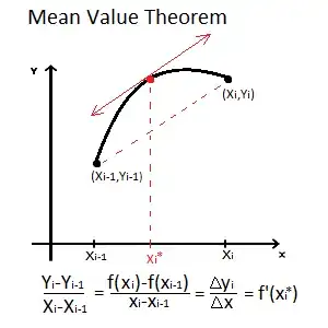

With the distance formula written in this form we can now use the Mean Value Theorem show below:
mean value theorem
Therefore:
$$f'\left(x_i^*\right) = \frac{\Delta y_i}{\Delta x}$$
$$\Delta y_i = f'\left(x_i^*\right)\Delta x$$
Now the distance formula becomes:
$$ = \sqrt{\left(\Delta x\right)^2 + \left(f'\left(x_i^*\right)\Delta x\right)^2}$$ $$ = \sqrt{\left(\Delta x\right)^2 + \left[1 + \left[f'x_i^*\right]^2\right]}$$
Since $\Delta x$ is positive
$$ = \Delta x\sqrt{1 + \left(f'\left(x_i^*\right)\right)^2}$$ $$ = \sqrt{1 + \left(f'\left(x_i^*\right)\right)^2}\Delta x$$
Where this calculates the length of a single line segment based on $\Delta x$.

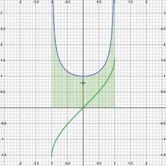

Now we can solve - evaluate our integral.
Problem: $$\arcsin(x) + C$$ Rewrite/simplyfy $$ = \int\sqrt{\cfrac{x^2}{1-x^2}+1}dx$$ This is standard integral: $$ = \arcsin(x)$$ The Problem is solved: $$\int\cfrac{1}{\sqrt{1-x^2}}dx$$ $$ i\ln\left(\left|\sqrt{x^2-1}+x\right|\right) + C$$
And this approximates $\pi$ with a value of $3.141592653589793$
Here's a graph of the approximate integral since computers can not perform infinite limits.
Final Result
    The OP computes the area, not the circumference. –  Oct 29 '20 at 09:12
  • @YvesDaoust The last graph shown is in terms of area. It is the area under the curve to the derivative of the function that was used between two bounds. Initially, an arbitrary arc was used to derive the Riemann Sum. We're not using it to find arc length, that's why we applied the derivative of a curved function to this Riemann Integral between two bounds. This does result in an area. If we only perform a discrete amount of steps in this Riemann Sum, the value will be approximate, but if you can apply it indefinitely through the use of limits it will give you the accurate value of PI. – Francis Cugler Oct 29 '20 at 12:30
  • My computer cannot afford an infinite amount of computation. Fortunately, I am not interested to see all decimals. –  Oct 29 '20 at 12:47
  • And I mean the area under the circle, not under another integrand, don't trick me. –  Oct 29 '20 at 12:48
  • @YvesDaoust Wasn't trying to trick you. Regardless of the units being to the 1st, 2nd, or 3rd power, etc... units, units^2, units^3, the resulting value is still PI agnostic of the units. The Integral does calculate PI very accurately between those two bounds, it's just that the more iterations you do or the smaller dx is, the more accurate the value will approximate to PI. It is when the number of iterations is at infinity and dx approaches 0, that you will get the true value of PI. This is one of the many reasons why PI is both irrational and transcendental. – Francis Cugler Oct 29 '20 at 20:35
  • What ?? Numerical integrals are approximate (except for low degree polynomials) whatever the value to which they converge, even integer. Is this a reason an integer could be irrational and transcendental ? –  Oct 29 '20 at 22:49
  • @YvesDaoust No, I'm referring to the fact that it requires an infinite summation of parts through integration is why PI is both irrational and transcendental, but the algorithm itself is the most accurate in calculating PI. The more finite or accurate you want the approximation to be, the more iterations and the smaller the dx must be. It will converge to exactly PI when dx approaches 0 and the number of iterations reaches infinity, which can't be done. This alone is why PI is irrational. Integers are not irrational, they will converge at a finite discrete point giving an exact value. – Francis Cugler Oct 30 '20 at 09:32
  • @YvesDaoust Anotherwords, $\pi$ is exactly equal to this integration. $\pi = \int_{-1}^1\sqrt{1+\left(\cfrac{-x}{\sqrt{1-x^2}}\right)^2}dx$ – Francis Cugler Oct 30 '20 at 09:37
