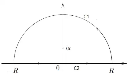

Now, consider the following integration paths:
So, I can write the above integral as:
$$Im\left[\lim_{ε\to0}\int_{-\infty}^{\infty}\frac{e^{ix}}{x-iε}dx\right]=Im\left[\lim_{ε\to0}\int_{C2}\frac{e^{ix}}{x-iε}dx\right]$$(of course $R\to \infty$)
Now, if we integrated the same integrand but the path was $C1$, it would give zero since the integrand tends to zero for large $Im[x]$ on the upper plane(this argument was used by a professor of our for a scattering problem in quantum mechanics).
So, we can now write:
$$Im\left[\lim_{ε\to0}\int_{C2}\frac{e^{ix}}{x-iε}dx\right]=Im\left[\lim_{ε\to0}\int_{C1+C2}\frac{e^{ix}}{x-iε}dx\right]$$which is an integral along a closed path that encloses the pole(residue) at $x=iε$. So, I can use the residue theorem to find that the integral is equal to: $$Im[\lim_{ε\to0}2\pi i Res(e^{i(iε)})]=2\pi $$ which is clearly off by a factor of 2.

    The function tens to 0 for large R but the length of the path of integration grows with R, so it's not so clear that the integral over the semi circle vanishes. – Ant May 07 '17 at 17:03
    @Ant but each small(but not infinitesimally small) part of the path at regions of large R don't contribute. So, summing them all up will again give zero. But, this argument is-again- not rigorous, so I'm not sure. But, I can say that this trick was used in a lecture(physics course) and we got the correct value. – TheQuantumMan May 07 '17 at 17:09
    Jordan's lemma demonstrates that the integral over the semi circle vanishes in the limit $R \to \infty$. – B. Mehta May 07 '17 at 17:11
  • @B.Mehta yes I used that in order to write the integral I started with as a closed-path integral and use Cauchy's theorem. – TheQuantumMan May 07 '17 at 17:13
    I think that you need to be clearer about the two straightline contours, they have to be indented round the poles at $0$ and at $i\epsilon$. I think you are not taking into account the contribution of the limit of the integral round the indentation. (I think.) – ancient mathematician May 07 '17 at 17:19
  • @ancientmathematician But I moved the pole at $x=0$ to $x=iε$ – TheQuantumMan May 07 '17 at 17:21
  • Yes, and what I cannot check is whether your 4th and 5th integrals are equal because I don't know if you've indented them both the same way or not. Maybe I am being slow. – ancient mathematician May 07 '17 at 17:28

The problem here is actually quite subtle, you've used the residue theorem correctly to evaluate the entire contour integral, and you've correctly identified that the integral over $C_1$ goes to $0$ as $R \to \infty$. This gave you a correct value for the imaginary part of the integral (for $\epsilon > 0$) $$\operatorname{Im}\left(\int_{-\infty}^{\infty}\frac{e^{iz}}{z - i \epsilon}d z\right) = 2\pi e^{-\epsilon}$$ which you can confirm here.
But, the problem happens when taking the limit as $\epsilon \to 0$, in that there's no guarantee that
$$\lim_{\epsilon \to 0} \int_{-\infty}^{\infty}\frac{e^{iz}}{z - i \epsilon}d z = \int_{-\infty}^{\infty} \lim_{\epsilon \to 0} \frac{e^{iz}}{z - i \epsilon}d z$$ This is where the solution breaks down, and your discrepancy here is a nice demonstration of how swapping the order of the limits needs more justification - in particular remember that the integral is defined as a limiting process, so some fairly strong continuity arguments would be required to show the left and right above would be equal. Of course in physics, you're used to assuming everything is as continuous as you'd like! In this particular case, it turns out $\int_{-\infty}^{\infty}\frac{e^{iz}}{z - i \epsilon}d z$ isn't continuous at $\epsilon=0$, so here's where your mistake is.
