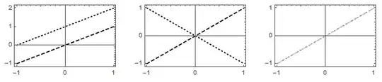

There are three possible cases for $2$ linear equations with $2$ unknowns (slope and intercept):
$\qquad$ $\mathbf{0}$ solution points $\qquad$ $\qquad$ $\mathbf{1}$ solution point $\qquad$ $\qquad$ $\mathbf{\infty}$ solution points
$\qquad \quad$ $\nexists$ no existence $\qquad$ $\qquad$ $\exists !$ uniqueness $\qquad$ $\qquad$ $\exists$ no uniqueness
The lines have the form $y(x) = mx + b$.
Case 1: parallel lines
A solution does not exist.
The lines are parallel: they have the same slope.
$$ % \begin{align} % y_{1}(x) &= m x + b_{1} \\ % y_{2}(x) &= m x + b_{2} \\ % \end{align} % $$
Case 2: intersecting lines
We have existence and uniqueness.
The slopes are distinct.
$$m_{1} \ne m_{2}$$
$$ % \begin{align} % y_{1}(x) &= m_{1} x + b_{1} \\ % y_{2}(x) &= m_{2} x + b_{2} \\ % \end{align} % $$
Case 3: coincident lines
We have existence, but not uniqueness. There is an infinite number of solutions. Every point solves the system of equations.
Both lines are the same.
$$ % \begin{align} % y_{1}(x) &= m x + b \\ % y_{2}(x) &= m x + b \\ % \end{align} % $$
In terms of linear algebra, look at the problem in terms of $\color{blue}{range}$ and $\color{red}{null}$ spaces.
The linear system for two equations is $$ % \begin{align} % m_{1} x - y &= b_{1} \\ % m_{2} x - y &= b_{1} \\ % \end{align} $$ which has the matrix form $$ % \begin{align} % \mathbf{A} x &= b \\ % \left[ \begin{array}{cc} m_{1} & -1 \\ m_{2} & -1 \\ \end{array} \right] % \left[ \begin{array}{cc} x \\ y \\ \end{array} \right] % &= % \left[ \begin{array}{cc} b_{1} \\ b_{2} \\ \end{array} \right] % \end{align} % $$
The Fundamental Theorem provides a natural framework for classifying data and solutions.
Fundamental Theorem of Linear Algebra
A matrix $\mathbf{A} \in \mathbb{C}^{m\times n}_{\rho}$ induces for fundamental subspaces: $$ \begin{align} % \mathbf{C}^{n} = \color{blue}{\mathcal{R} \left( \mathbf{A}^{*} \right)} \oplus \color{red}{\mathcal{N} \left( \mathbf{A} \right)} \\ % \mathbf{C}^{m} = \color{blue}{\mathcal{R} \left( \mathbf{A} \right)} \oplus \color{red} {\mathcal{N} \left( \mathbf{A}^{*} \right)} % \end{align} $$
Case 1: No existence
The matrix $\mathbf{A}$ has a rank defect $(m_{1} = m_{2})$ and $b_{1} \ne b_{2}$. $$ b = \color{blue}{b_{\mathcal{R}}} + \color{red}{b_{\mathcal{N}}} $$ It is the $\color{red}{null}$ space component which precludes direct solution. (Interestingly enough, there is a least squares solution.) $$
The data vector $b$ is not a combination of the columns of $\mathbf{A}$. The column space is $$ \mathbf{C}^{2} = \color{blue}{\mathcal{R} \left( \mathbf{A} \right)} \oplus \color{red} {\mathcal{N} \left( \mathbf{A}^{*} \right)} $$ The decomposition is $$ \color{blue}{\mathcal{R} \left( \mathbf{A} \right)} = % \text{span } \left\{ \, \color{blue}{ \left[ \begin{array}{c} m \\ -1 \end{array} \right] } \, \right\} \qquad \color{red}{\mathcal{N} \left( \mathbf{A}^{*} \right)} = % \text{span } \left\{ \, \color{red}{ \left[ \begin{array}{r} -1 \\ m \end{array} \right] } \, \right\} $$
Case 2: Existence and uniqueness
The matrix $\mathbf{A}$ has full rank $(m_{1}\ne m_{2})$. The data vector is entirely in the $\color{blue}{range}$ space $\color{blue}{\mathcal{R} \left( \mathbf{A} \right)}$ $$ b = \color{blue}{b_{\mathcal{R}}} $$
The $\color{red}{null}$ space is trivial: $\color{red}{\mathcal{N} \left( \mathbf{A}^{*} \right)}=\mathbf{0}$. $$ \mathbf{C}^{2} = \color{blue}{\mathcal{R} \left( \mathbf{A} \right)} $$ The decomposition is $$ \color{blue}{\mathcal{R} \left( \mathbf{A} \right)} = % \text{span } \left\{ \, \color{blue}{ \left[ \begin{array}{c} m_{1} \\ -1 \end{array} \right] }, \, \color{blue}{ \left[ \begin{array}{c} m_{2} \\ -1 \end{array} \right] } \right\} $$
Case 3: Existence, no uniqueness
The matrix $\mathbf{A}$ has a rank defect $(m_{1} = m_{2} = m)$, yet $b_{1} = b_{2}$. $$ b = \color{blue}{b_{\mathcal{R}}} $$ The column space is has $\color{blue}{range}$ and $\color{red}{null}$ space components: $$ \mathbf{C}^{2} = \color{blue}{\mathcal{R} \left( \mathbf{A} \right)} \oplus \color{red} {\mathcal{N} \left( \mathbf{A}^{*} \right)} $$ The decomposition is $$ \color{blue}{\mathcal{R} \left( \mathbf{A} \right)} = % \text{span } \left\{ \, \color{blue}{ \left[ \begin{array}{c} m \\ -1 \end{array} \right] } \, \right\} \qquad \color{red}{\mathcal{N} \left( \mathbf{A}^{*} \right)} = % \text{span } \left\{ \, \color{red}{ \left[ \begin{array}{r} -1 \\ m \end{array} \right] } \, \right\} $$
