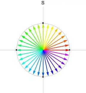

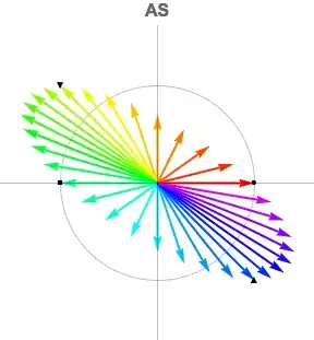

Consider the matrix $$ \mathbf{A} = \left[ \begin{array}{rr} 1 & -1 \\ 0 & 1 \\ \end{array} \right]. $$ which has singular values $$ \sigma = \left( \sqrt{\frac{1}{2} \left(\sqrt{5}+3\right)},\sqrt{\frac{1}{2} \left(3-\sqrt{5}\right)}\right) \approx (1.61803, 0.618034) $$ The map of a matrix onto a unit circle (left) creates an ellipse (right).
s2enter image description here

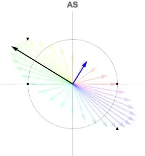

This next image overlays the column vectors from the SV decomposition matrix $\mathbf{V}$, scaled by the singular values. The matrix grows in directions where the singular value exceeds unity.
columns
