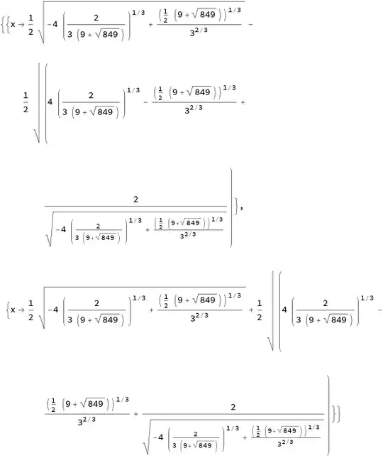

  • There is a closed form, wolfram alpha will show it to you, if you click the "exact form" button. They're pretty nasty, though. – Joppy May 03 '17 at 10:48
  • See this: https://math.stackexchange.com/questions/785/is-there-a-general-formula-for-solving-4th-degree-equations-quartic – larry01 May 03 '17 at 10:55
According to wolfram alpha, exact form of this solutions are
The former is positive solution.
