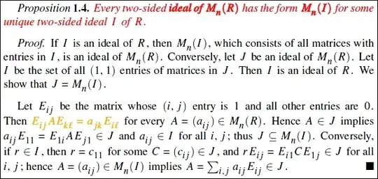

A faster, and more general result, which Arturo hinted at, is obtained via following proposition from Grillet's Abstract Algebra, section "Semisimple Rings and Modules", page 360:
Consequence: if $R:=D$ is a division ring, then $M_n(D)$ is simple.
Proof: Suppose there existed an ideal of $M_n(D)$. By the proposition, it'd be of the form $M_n(I)$, for $I\unlhd D$, but division rings do not have any ideals (other than $0$ and $D$), so this is a contradiction. $\blacksquare$

    So if $R$ is a simple ring, then so too is $M_n(R)$, right? – goblin GONE Sep 16 '15 at 12:57
  • @goblin That's right. But for more specific results about simple rings, see Wedderburn's theorem and Thm.11.3.8, p.368 in Grillet. – Leo Sep 20 '15 at 10:43
