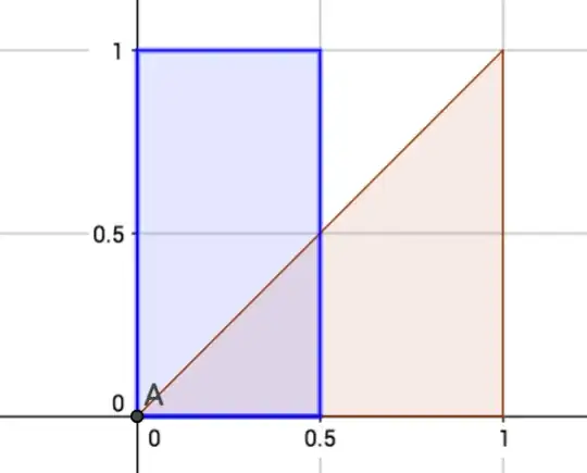

I'm trying to test it with the artificial example a friend of mine came up: Sample space: unit square
Consider the sample space in the picture which is the unit square.
Event $A$ - the blue rectangle
Event $B$ - the brown triangle
$P(A)=0.5$
$P(B)=0.5$
$P(A\cap B)=0.125$
Obviously, $P(A)*P(B)\neq P(A\cap B)$ and I conclude that $A$ and $B$ are also dependent.
So, I am wrong saying that if $A$ and $B$ are not disjoint, they are always independent?
  • @Lazy Lee Nope, because if $A$ and $B$ are disjoint, they are dependent, but if they are not disjoint, does it mean that they are independent?
    I know that my example does contradict that, but does it exhaust all the possible cases?
    – alekscooper May 02 '17 at 08:11
    Yes, you are wrong in saying that. Compliments for your friends example. – drhab May 02 '17 at 08:11
    Another thing: "If $A$ occurs then it gives us the information that $B$ didn't occur..." Yes, but that information is useless if the probability that $B$ will occur is $0$. (see also the answer of Mees). – drhab May 02 '17 at 08:27
  • My final paragraph here offers two examples of non-disjoint pairs of events: the first pair is independent, while the second pair is dependent. In short: dependence/independence cannot be inferred from non-disjoint events. – ryang Apr 03 '22 at 12:40
Yes, you are wrong in saying that, as your example demonstrates.
Note that disjoint does not imply dependent in an general either: if $A = \emptyset$, then $$ P(A \cap B) = P(\emptyset) = 0 = 0\cdot P(B) = P(\emptyset)P(B) = P(A)P(B), $$ so the empty set is disjoint from every set, and also independent from every set.
