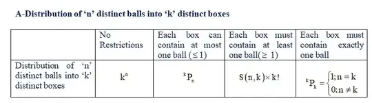

The solution is as follow enter image description here
Hence the Solution is as follow $S\left( {n,k} \right) \times k! = {}^k{C_0}.{\left( {k - 0} \right)^n} - {}^k{C_1}.{\left( {k - 1} \right)^n} + {}^k{C_2}.{\left( {k - 2} \right)^n} + .. + {\left( { - 1} \right)^{n - 1}}.{}^k{C_{k - 1}}{\left( {k - \left( {k - 1} \right)} \right)^n}$
Which is called the Sterling Number of Second order
