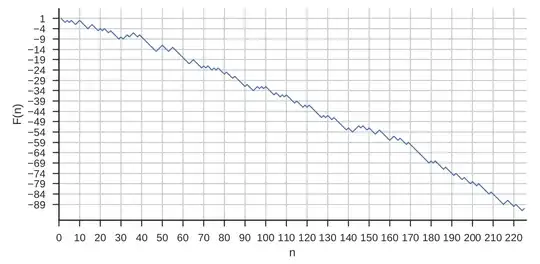

Now let's define another function $F$ by $F(n) = \min \{L_A(n) : A \subseteq \mathbb{P}\}$. First few values of $F$ are $1, 0, -1, 0, -1, 0, -1, -2, -1, 0, -1, -2, -3, -4, -3, -2, -3, -4, -5, -4, -5, -4, -5, -6, -5, -6, -7, -8, -9$ And here is a graph for small values:
graph2 My algorithm for calculating $F$ is as follows: Consider all possible values on prime numbers not bigger than $\sqrt{n}$. For every other prime we know whether we want to set $-1$ or $1$ on it, because it depends only on sum of values on numbers smaller than $\sqrt{n}$. So the complexity is $O\left(n 2^{\frac{2\sqrt{n}}{\log{n}}}\right)$.

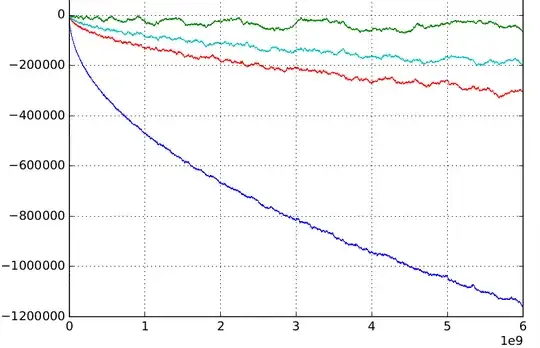

I am also interested in function $L_{\mathbb{P} \setminus \{2\}}$. All questions above can be applied also to this function, but answers to the fourth and fifth are the same as for the standard $L$. I believe this function should be much easier to investigate, because we can use similar methods as in investigating Polya's conjecture. Here is a graph of $L$ (green), $L_{\mathbb{P} \setminus \{3\}}$ (light blue), $L_{\mathbb{P} \setminus \{2\}}$ (red) and $L_{\mathbb{P} \setminus \{2, 3\}}$ (dark blue): X,2,3,(2,3)
