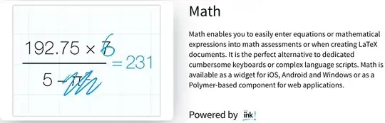

You might explore MyScript Math:
MathScript
