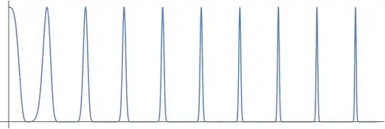

Hint. If $\lim_{x\to\infty} f(x)$ fails to exist but the integral $\int_{a}^{\infty} f(x) \, dx$ converges, then we often observe a 'train of narrowing peaks':
$\hspace{3em}$enter image description here
This means that you begin to see an abrupt change in $f(x)$ for large $x$. How the uniform continuity enters this picture is that it prevents peaks from being both high and narrow. So it becomes harder to observe high peaks as $x\to\infty$.
Sketch of Proof. (Hover the cursor to see the content.)
To convert this argument to a solid proof, assume otherwise that $|f(x)| \nrightarrow 0 $. Then you can find $\epsilon > 0$ and $x_n \to \infty$ such that $|f(x_n)| > \epsilon$. Now you can utilize uniform continuity to argue that there exists $\delta, \epsilon > 0$ for which $$ \left| \int_{x_n-\eta}^{x_n+\eta} f(t) \, dt \right| \geq \delta $$ holds for all $n$. (I will leave this part to OP.) This shows that $\int_{a}^{x} f(t) \, dt$ is not Cauchy as $x \to \infty$, so it cannot converge as $x \to \infty$.
