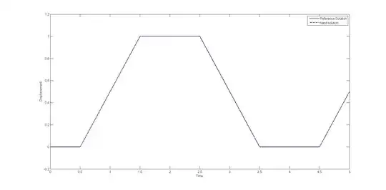

Plotting this for $x=L/2$ and $t$ from $0$ to $5$ against a reference solution yields the following plot
Where the red is the reference solution and the blue is the solution proposed by @DisintegrationByParts.
EDIT 2
The reference solution I am using is the following: enter image description here
where $\lambda = \frac {(2n-1)\pi}{2L}$ and $p_0=K=L=c=1$

  • I don't believe it is worth checking the boundaries because as I showed above the actual solution itself does not match up. I have added a second edit with the reference I am using (red plot). It looks similar to the solution I came up with but not quite the same. – user32882 May 13 '17 at 06:03
  • nevermind. Your solution is 100% correct. It was a bug in the algorithm I was implementing to check it. Upon comparing the reference solution with the one suggested by your answer, it turns out they are exactly equal for the given parameters, p0=k=L=c=1. I will remove the erroneous plot I produced from the original question and accept your answer as the final answer. – user32882 May 13 '17 at 09:24
