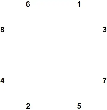

This is not a rigorous proof, but an interesting geometric intuition. Those matrices are different kinds of reflections (about origin, about $y=x$, etc). As an example, pick $(2,1)$ and transform it with each of those matrix. You have (label $i$ means the $i$th matrix is applied)
reflection
It's apparent that those transformations are "geometrically closed".
