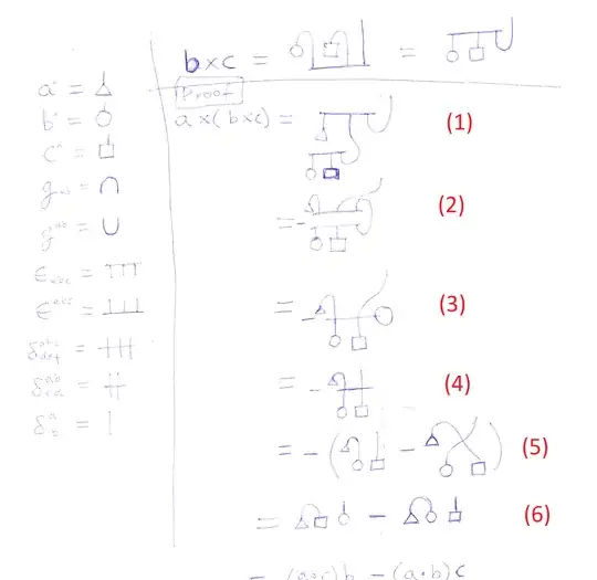

I just want to add a proof using my favourite method for this kind of thing: Penrose graphical notation. I think it is as coordinate free as you can go.
Every piece of the diagram has a meaning. Tensors are shapes with a lines going upwards or downwards, depending on the type of tensor. For example, vectors have 1 line going upwards, and covectors one line going downwards. Contracion is represented joining the lines.
For example: the first line on the right side, over the word "proof", is the statement $(b\times c)^{a} = b^{b}c^{c}g_{bd}g_{ce}\epsilon^{dea} = b^{b}c^{c}\epsilon_{bcd}g^{da}$ where the indices are proper abstract indices: they do not represent components, but the slots of the tensors.
At the bottom I repeat the properties I use.
Penrose graphical notation proof
  1. Antisymmetry of $\epsilon^{abc}$
  2. $\epsilon^{abc}\epsilon_{def} = \delta^{abc}_{def}$
  3. $\delta^{abc}_{dec} = \delta^{ab}_{de}$
  4. $\delta^{ab}_{cd}A_{ab} = 2A_{[cd]} = A_{cd} - A_{dc}$
