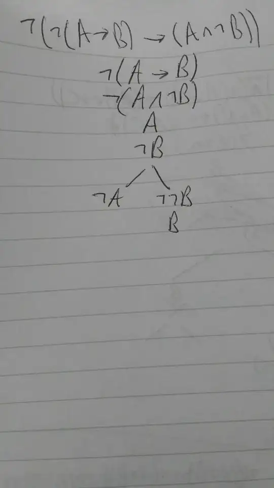

What you have to do is show that $\lnot (\lnot(A\to B)\to(A\land\lnot B))$ is a tautology. But the tableau of its negation is closed:
enter image description here.
(Each path contains a contradiction.) Hence the result.
