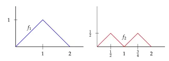

Consider the following sequence of piece-wise smooth functions $f_n:[0,2]\rightarrow \mathbb{R}$ (below drawn first two functions by their graphs, and is contunued then in natural way.)
The function $f:[0,2]\rightarrow \mathbb{R}$, $f(x)=0$ for all $x$ is the limit of this sequence.

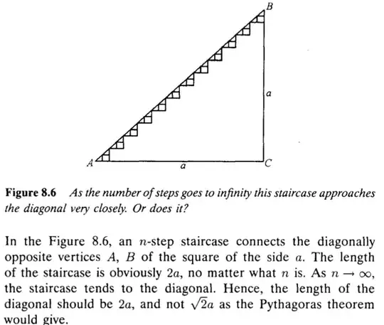

Q. 1 Note that the lengths of graph of each $f_n$ is $2\sqrt{2}$, but the length of limiting function is not $2\sqrt{2}$; why this happens? (Such problem appears as a puzzle shown below picture in some book, but I was looking it through a sequence of functions, it convergence etc.)
Here sequence $f_n$ converges to $f$ uniformly; but still the length of their graphs do not converges to length of graph of limit of $f_n$. This raises following question:

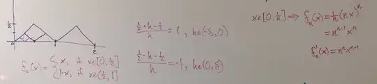

I have decided to add a picture of the work that went into my original answer (excuse the notation abuse with $\,f_n$ on the right-hand side) enter image description here

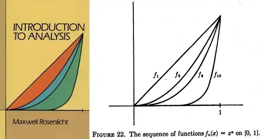

Along with Beginner's interesting question here and ThePortakal's comment in another thread, this Dover book was helpful in motivating the sequence $\{g_n\}_{n=1}^\infty$.
