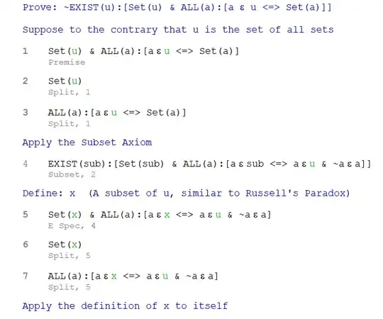

In a case such as this that may be controversial, a formal proof is called for. Here is my formal proof of the non-existence of a set of all sets (only 25 lines of proof + commentary in blue text). It makes use of a form of natural deduction. Unlike standard ZFC, I make use of a unary predicate Set. Set(x) means that x is a set.
In gray text, under each formal statement is given the rule of inference used to generate that statement plus optional pointers to previous statement(s).
(A plain-text version follows this proof.)
enter image description here enter image description here enter image description here enter image description here

Prove: ~EXIST(u):[Set(u) & ALL(a):[a in u <=> Set(a)]]
Suppose to the contrary that u is the set of all sets
1 Set(u) & ALL(a):[a in u <=> Set(a)] Premise
2 Set(u) Split, 1
3 ALL(a):[a in u <=> Set(a)] Split, 1
Apply the Subset Axiom
4 EXIST(sub):[Set(sub) & ALL(a):[a in sub <=> a in u & ~a in a]] Subset, 2
Define: x (A subset of u, similar to Russell's Paradox)
5 Set(x) & ALL(a):[a in x <=> a in u & ~a in a] E Spec, 4
6 Set(x) Split, 5
7 ALL(a):[a in x <=> a in u & ~a in a] Split, 5
Apply the definition of x to itself

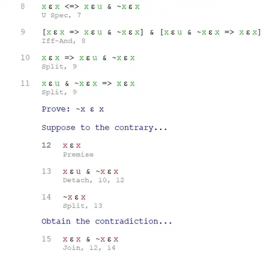

8 x in x <=> x in u & ~x in x U Spec, 7
9 [x in x => x in u & ~x in x] & [x in u & ~x in x => x in x] Iff-And, 8
10 x in x => x in u & ~x in x Split, 9
11 x in u & ~x in x => x in x Split, 9
Prove: ~x in x
Suppose to the contrary...
12  x in x
    Premise
13  x in u &amp; ~x in x
    Detach, 10, 12
14  ~x in x
    Split, 13
Obtain the contradiction...
15  x in x &amp; ~x in x
    Join, 12, 14
By contradiction...
As Required:

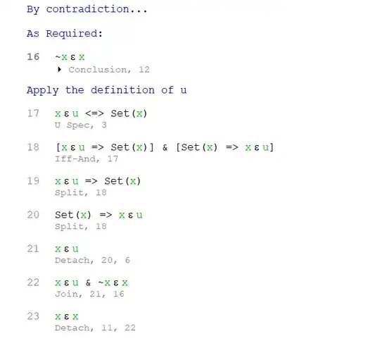

16 ~x in x Conclusion, 12
Apply the definition of u
17 x in u <=> Set(x) U Spec, 3
18 [x in u => Set(x)] & [Set(x) => x in u] Iff-And, 17
19 x in u => Set(x) Split, 18
20 Set(x) => x in u Split, 18
21 x in u Detach, 20, 6
22 x in u & ~x in x Join, 21, 16
23 x in x Detach, 11, 22

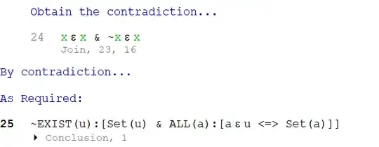

24 x in x & ~x in x Join, 23, 16
By contradiction...
As Required:
25 ~EXIST(u):[Set(u) & ALL(a):[a in u <=> Set(a)]] Conclusion, 1
