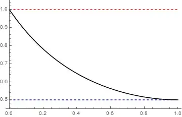

The following is the graph of $\alpha \mapsto I(\mu_{\alpha})$.
$\hspace{8em} $enter image description here
