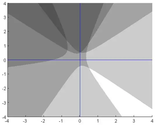

Let us formalize your question. (see first picture below)
Let $A_{0,a,b}$ be the region defined by inequality
$$\tag{*}\frac{x^2}{a^2}-\frac{y^2}{b^2}>1,$$
and $A_{\theta,a,b}$ the image by a rotation of angle $\theta$ of region $A_{0,a,b}$ (this rotation having its center in 0).
The essential property is that all regions $A_{\theta,a,b}$ are convex.
As the intersection of any number of convex sets is convex (Proof that the intersection of any finite number of convex sets is a convex set), you have a convex result (the darker region in the picture).
Last topological point: a convex set is a connected set (Show that any convex subset of $R^k$ is connected) i.e. is a "whole", in the sense that it cannot be in two or more separate parts.

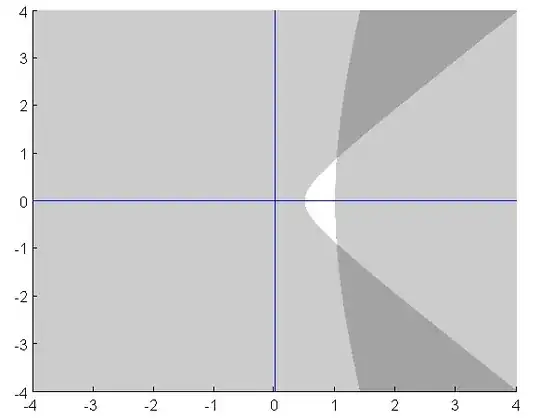

Now, after an explanation with WYC (see our exchanges), one can consider the case I have treated upwards as exceptional. The general case where complementary regions: $B_{0,a,b}$ defined by inequality
$$\frac{x^2}{a^2}-\frac{y^2}{b^2}\leq1$$
are used as well, with $B_{\theta,a,b}$ defined in the same way as $A_{\theta,a,b}$ in (*). Note that $B_{\theta,a,b}$ is a concave set.
Thus the true question is as follows: Let $C_{\theta,a,b}$ equal either to a $A_{\theta,a,b}$ or to a $B_{\theta,a,b}$.
What can be said of a finite intersection :
$$C_{\theta_1,a_1,b_1} \cap C_{\theta_2,a_2,b_2} \cap \cdots \cap C_{\theta_n,a_n,b_n} ?$$
In particular, is it a connected set ?
The Matlab program given below provides a visual picture (see Fig. 2) of this intersection.
But the answer to the connectedness is no in general. It suffices (see fig. 3) to consider branches of hyperbolas $H_1$ and $H_2$ with resp. equations $y=\pm \sqrt{x^2-0.25}$ and $y=\pm \sqrt{x^2-1},$ and take the convex region to the right of $H_1$ and the concave region to the left of $H_2$.
