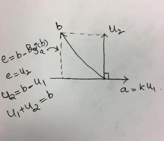

Just to give you a pictorial view of the problem. ${e}$ is the error. Just to give you a pictorial view of your problem.
