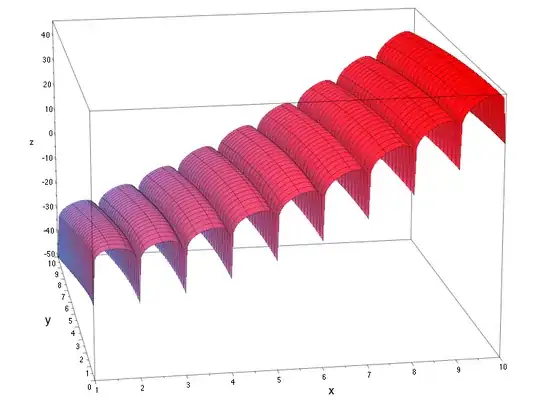

Visual representation of the logarithm of your function : Visual ln
