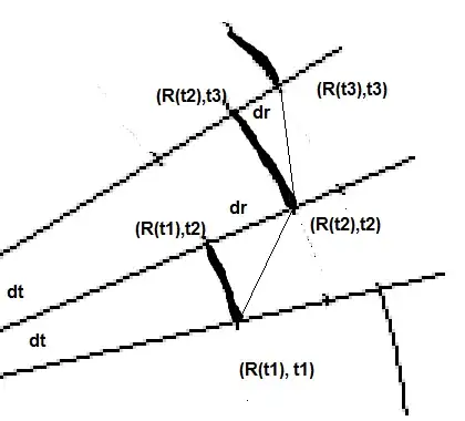

Arc Length in polar coordinates
In the figure, I have taken a curve in Polar coordinates which I have broken up into pieces. If we calculate $\int_0^{2\pi} r\ d\theta$ we will get the sum of the dark lines. It will give you the average value of $r,$ times the range of $\theta$ but it will underestimate the arc length
If you want the arc length, you are going to need the diagonals. in that figure.
What is the length of the diagonal. As $d\theta$ becomes small, they are aproximately right triangles with one leg $r\ d\theta$ and the other leg, $dr$
And hypotenuse $\sqrt {(r\ d\theta)^2 + (dr)^2)}$
$\int \sqrt {(r^2 + (\frac{dr}{d\theta})^2} \ d\theta$ will give you the arc length

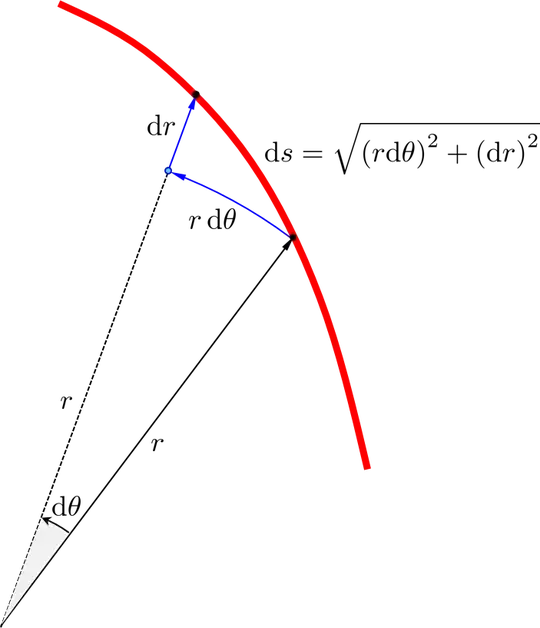

It is the pythagorean theorem that gives as the arc length for a curve in any coordinates.
Consider a small segment ${\rm d}s$ starting from $(r,\theta)$ and going to $(r+{\rm d}r,\theta + {\rm d}\theta)$. As you see in the diagram below the distance due to the angle change is $r {\rm d}\theta$ and the distance due to the radius changing is ${\rm d}r$. Those need to added vectorially to get the displacement of the curve ${\rm d}s$.
pic
