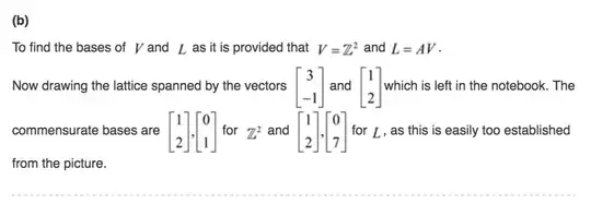

I think we need that because the solution says the basis for $V$ is $\{(1,2) , (0,1)\}$ while the basis for $L$ is $\{(1,2),(0,7)\} $.
But it says we can conclude that from the sublattice. So, can someone briefly point out how I can sketch the sublattice?

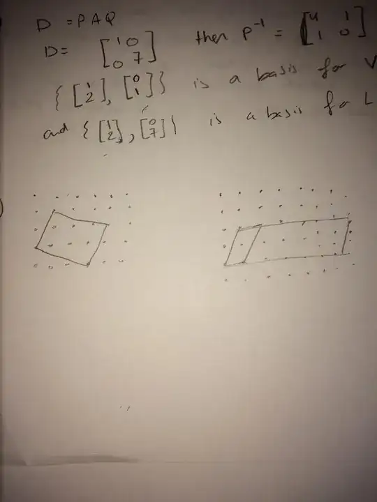

Also my attempt at drawing it: enter image description here

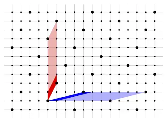

The row and column operations you use in computing the Smith normal correspond to invertible matrices $P,Q \in \operatorname{GL}_2(\mathbb{Z})$ such that $$ D = PAQ $$ where $D$ is the diagonal matrix you found. (Since $-1$ is invertible in $\mathbb{Z}$, we can actually take $D$ to be $$ D = \begin{pmatrix} 1 & 0\\ 0 & 7\end{pmatrix} $$ which is what I will use for the rest of the answer.) In this case, I get $$ D = \left(\begin{array}{rr} 1 & 0 \\ 0 & 7 \end{array}\right) \qquad P = \left(\begin{array}{rr} 0 & 1 \\ 1 & -4 \end{array}\right) \qquad Q =\left(\begin{array}{rr} 1 & 2 \\ 1 & 1 \end{array}\right) \, . $$
We can interpret these as change of basis matrices for $V$. (For more on this, see this post or this post.) The change of basis matrix $P$ contains the information we seek: since $P^{-1} = \begin{pmatrix} 4 & 1\\ 1 & 0\end{pmatrix}$, then the set $$ \{v_1, v_2\} = \left\{\begin{pmatrix} 4\\ 1\end{pmatrix}, \begin{pmatrix} 1\\ 0\end{pmatrix}\right\} $$ is a basis for $V$ such that $L = v_1 \mathbb{Z} \oplus 7v_2 \mathbb{Z}$.

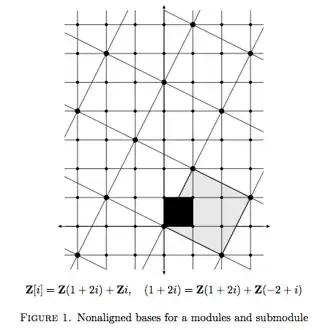

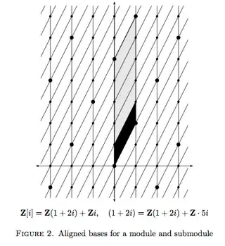

As for drawing the sublattice, take a look at pp. 4-5 of this set of notes by Keith Conrad. He draws a lattice and sublattice with respect to so-called unaligned and aligned bases, which I've copied below.
I think this is the sort of picture you have in mind. All right, below is my attempt at drawing the lattice $V$ and its sublattice $L$. The blue parallelograms are the fundamental parallelograms of $V$ and $L$ using my basis, and the red is the same for the book's. This shows quite clearly that both answers are correct.

  • It's {(1,2),(0,1)} that's a basis for v, no? – Lana Mar 14 '17 at 23:03
  • That's not what I got. I'll edit to add a few more details. Could this be a result of you choosing $-7$ rather than $+7$ as the bottom-right entry of $D$? – Viktor Vaughn Mar 14 '17 at 23:08
  • I just added the sample answer – Lana Mar 14 '17 at 23:10
  • ok I tried to draw according to your reference lol.. not the prettiest drawing – Lana Mar 14 '17 at 23:17
  • I have a feeling that both my answer and the book's are correct, meaning that the answer is not unique. You can see that $(4,1)^T$ and $(7,0)^T$ definitely generate $L$ since $(3,-1)^T = (7,0)^T - (4,1)^T$ and $(1,2)^T = 2 \cdot (4,1)^T - (7,0)^T$, so my answer works. – Viktor Vaughn Mar 14 '17 at 23:26
  • Oh ok that's fine. Do you think that's how we draw a sublattice? (not sure if i completely failed at this) – Lana Mar 14 '17 at 23:33
  • I think you drew $(1,0)$ instead of $(0,1)$ in your picture... – Viktor Vaughn Mar 14 '17 at 23:35
  • To draw the lattice, draw the parallelogram with vertices $0,v_1,v_2$, and $v_1+v_2$. For the sublattice, the vertices are instead $0, v_1, 7v_2$, and $v_1+7v_2$. – Viktor Vaughn Mar 14 '17 at 23:41
  • oh ok, should the lattice and sublattice be separate? or the same diagram? – Lana Mar 14 '17 at 23:47
