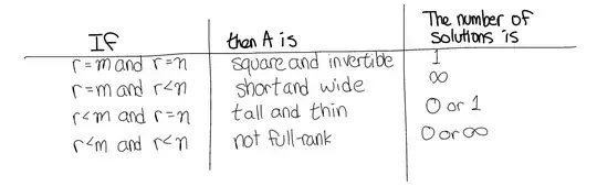

I found a table in my notes that you might find useful. In the below, the matrix is $m \times n$ ($m$ equations and $n$ variables), and $r$ denotes the rank of the associated matrix.
