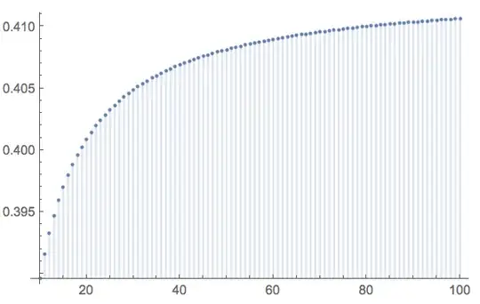

A 'numerical approximation' $\ds{\,\mc{N}_{q}}$ is given by:
\begin{align} \int_{0}^{1}H_{x}^{2}\,\dd x & \approx \gamma^{2} + {1 \over q}\sum_{p = 1}^{q - 1}\bracks{\Psi\pars{p \over q} + {q \over p}}^{2} \equiv \,\mc{N}_{q} \end{align} The figure shows $\ds{\,\mc{N}_{q}\ \mbox{vs.}\ q}$. enter image description here

  • Many thanks for your answer, I've understand details, and your answer is a good introduction to the theory of the digamma function. –  Mar 31 '17 at 07:03
  • @user243301 I'm glad you found tthis answer was useful. – Felix Marin Mar 31 '17 at 20:04
