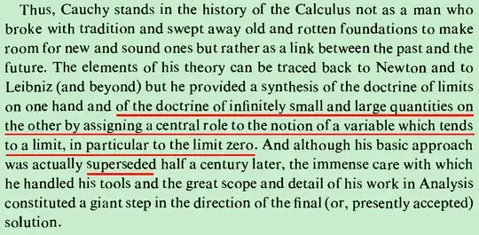

(2). Robert Goldblatt, Lectures on the Hyperreals: An Introduction to Nonstandard Analysis, P15 (His = Cauchy's) enter image description here Why says 'Even'?
(3). Abraham Robinson, Non-standard analysis, P276 enter image description here why Cauchy's definition of infinitesimal, along with his 'basic approach' was superseded?

You ask "why Cauchy's definition of infinitesimal, along with his 'basic approach' was superseded?"
The answer is that Cantor, Dedekind, Weierstrass and others developed a foundation for analysis to deal with certain difficulties related to Fourier series, uniform continuity, and uniform convergence. This development resulted in a formalisation that was a decisive moment in the history of analysis and was a great accomplishment. This is all well-known and rivers of ink have been spilt on the subject.
Yet the great accomplishment masked a significant failure that is less frequently spoken about. Namely, these 19th century giants failed to formalize an aspect of the procedures of calculus and analysis that was ubiquitous until and including Cauchy, namely the notion of infinitesimal. Instead, they provided infinitesimal-free paraphrases for the traditional definitions. For example, Cauchy's lucid definition of continuity of $y=f(x)$ ("infinitesimal change in $x$ always leads to infinitesimal change in $y$") got replaced by the familiar jargon ("for every epsilon there exists a delta such that, if $|x-c|$ is less then delta, then $|f(x)-f(c)|$, etc.").
Not only did they fail to formalize it but, unable to do so, some of them became convinced that there was something wrong with the notion of infinitesimal itself, and from this jumped to the conclusion that infinitesimals must be inconsistent or self-contradictory. Cantor went as far as publishing an article claiming to "prove" that infinitesimals were inconsistent. In correspondence Cantor referred to infinitesimals as "paper numbers", "cholera bacillus of mathematics", and even "abomination"; the details can be found in
Dauben, Joseph Warren. Georg Cantor. His mathematics and philosophy of the infinite. Princeton University Press, Princeton, NJ, 1990
and
Ehrlich, Philip. The rise of non-Archimedean mathematics and the roots of a misconception. I. The emergence of non-Archimedean systems of magnitudes. Arch. Hist. Exact Sci. 60 (2006), no. 1, 1–121.
A solid set-theoretic formalisation for infinitesimals did not emerge until around 1960 and by then Weierstrassian paraphrases were solidly in place, making it difficult to overcome institutional inertia.
Cauchy's idea of representing an infinitesimal by a sequence tending to zero is basically valid, but needs some polishing. Cauchy's infinitesimal specifically is dealt with in a number of articles that you can find here.

Because Cauchy's formulation doesn't quite correspond to what we want it to be. For example, suppose $y$ is a function of $x$. Per Cauchy, we take $dx$ to be some decreasing value. What does that mean mathematically? Decreasing with respect to what? Evidently, $dx$ is to be a function of some other variable, which I'll call $t$. $dx = dx(t)$. Calling it a sequence as one of your quotes does just restricts the domain of $t$ to the natural numbers. The requirement on the function is that some appropriate limit with respect to $t$ of $dx(t)$ is $0$.
Now $dy$ is also some function of $t$, determined by the relationship between $y$ and $x$. In particular, $dy(t) = y(x + dx(t)) - y(x)$. Well and good, but by this definition, $\frac{dy}{dx}$ is a function of both $x$ and $t$. That is not what we want. We want $\frac{dy}{dx}$ to be the derivative, which is a function of $x$ alone. By the Cauchy definition, $$y'(x) = \lim_t \frac{dy}{dx} \ne \frac{dy}{dx}$$ Since the latter depends on $t$.
So Cauchy's idea came closer to putting the idea on a solid foundation, but it still needed refining. Once suitable refinments were established, it has fallen out of favor.

  • Note that the quotation from Robinson conveniently provided by @iMath neatly summarizes Cauchy's role in the history of analysis. Alas, it is often lost in the rattle of historians attempting to present the history of analysis as an inevitable march toward Weierstrassian epsilontics. – Mikhail Katz Mar 13 '17 at 17:01

Robinson's definition of infinitesimal can be seen as a refinement of Cauchy's. In Robinson's definition, a hyperreal number is an equivalence class of sequences of real numbers, and it's a key theorem (for the relationship between standard and nonstandard analysis) that such a hyperreal number is infinitesimal (in the ordering that Robinson defines) if and only if any/all of the convergent sequences in its equivalence class converge to zero. (The equivalence class will also have some divergent sequences, although zero will still be a cluster point of all of them.) If we formalize a "variable" that converges to zero as a sequence that converges to zero, then every infinitesimal in Cauchy's sense gives rise to an infinitesimal in Robinson's sense.
Not everything is the same. I expect that if you presented Cauchy with $x = (-1)^n/n$ as a variable that converges to zero (as $n \to \infty$), then he might accept that as defining a nonzero infinitesimal that is neither positive nor negative. But every nonzero hyperreal number is either positive or negative. The choice of free ultrafilter used in Robinson's construction of hyperreals determines whether the hyperreal associated to this particular sequence is positive or negative (it is definitely nonzero), and that is completely arbitrary. But it must be one or the other.
I suppose that one would argue that $x = (-1)^n/n$ is simply not going to be useful in any argument with infinitesimals, and certainly Cauchy usually worked with infinitesimal variables such as $x = 1/n$ (which is definitely positive). But I don't know that Cauchy would never find it useful or that every argument of Cauchy's can be directly translated into an argument in Robinson's nonstandard calculus.
