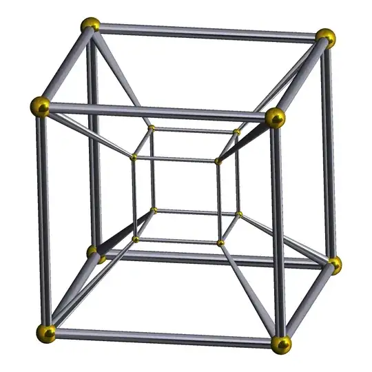

In what sense is a tesseract (shown) 4-dimensional?

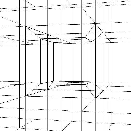

Let's try this in 4D : we consider a 3D cube like the previous one and represent a smaller cube inside the first one. Again we imagine that, as we progress in the new perpendicular direction, the smaller cube will grow until taking the place of the larger one ; a new one will appear at the center, grow and so on... Here too we remain at a fixed position of our support cube which will cross other identical cubes while moving in the perpendicular direction.
An actual 4D-entity should occupy a continuum of contiguous cubes.
3D

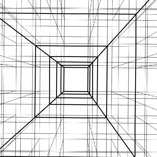

To move in 'full-4D' you may imagine that cubes are filling the whole 3D space (generating a 3D grid).
Superpose to this 3D grid a smaller and parallel one (or an infinity of smaller and larger ones if you want...) that has a junction at every vertex with the corresponding vertex of the larger one. This will give you a 4D grid and as you move in 4D the smaller grid will take the place of the larger one, a new small grid will get out of the 'mist', grow and so on...
Grid4D (4D grid variant)
At this point you may imagine moving in your 3D cube or turning around it (changing only the perspective effect) and even the more confusing 4D rotations.

The key to the answer to this question is already in the word "visualize": It contains "visual", which refers to seeing. Indeed, when you visualize something, you quite literally activate the same structures in your brain that you would also activate when seeing it. You are actually, in a quite direct sense, putting it in front of your "inner eye". Note that also in "imagine" there's the word "image", which also refers to seeing.
This can be seen(!) in a few self-experiments. First, visualize a common item. Let's say a teapot. When you put this teapot in front of your inner eye, you see it the same way you would if you were looking at it. In particular, you'll see the outside, but not the inside (unless you mentally go inside the imagined teapot, in which case you see the inside, but not the outside). Also, you see the side facing you, but not the opposite side.
Now imagine the teapot getting smaller and smaller. For a real shrinking teapot, as it reaches the boundary of your vision, it will lose structure until it ends up as a little point. And you'll notice that the same will happen with your imagined teapot. Note that I'm assuming that you really imagine it shrinking; you can of course instead keep its size in your imagination and put a "mental label" on it "like this, but much smaller". But you cannot imagine, in the literal sense, a microscopically small teapot with all its structure.
Or in other words, strictly speaking you cannot even visualize Euclidean space.
Now the answer to your question is obvious: You cannot visualize the tesseract because you cannot see it. Our eyes do projections of the three-dimensional space into the two-dimensional spaces of our retinas, and our brain then interprets those two images. The tesseract doesn't live in that three-dimensional space projected onto our retinas.
So does this mean we're out of luck? Well, not completely. While in nature there are no tesseracts to see, and no extended four-dimensional space to see in which they could be put, we can do a mathematical projection of the tesseract into three-dimensional space, and then use computers and our visual apparatus (and, after some experience, also our imagination) to make mental images of those projections, while using our abstract understanding together with our three-dimensional intuition/experience on how projections from 3D to 2D behave, to interpret those projections.
Using this method, it is indeed possible to develop a certain feeling for some aspects of four-dimensional objects, like the tesseract. However note that it will never be as natural as the three-dimensional experience which our brain explicitly evolved for (because our ancestors would not have survived without a sufficient understanding of three-dimensional space).
