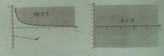

Let $F=\{(x,y)\in \mathbb{R}^2 : xy\geq 1\}$ be the set of points $(x,y)$ which lie on and above the arm of hyperbola $xy=1$ in the first quadrant and C be the Y-axis. then
$F+C=\{ (x,y):x>0\}$ which is not closed.
See the above figure in first picture $F$ and $C$ both are closed but in second picture $F+C$ is not closed.
