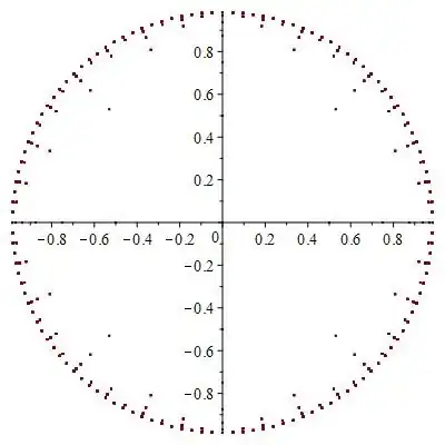

Unless some mistake eludes me below, it should not hold. Consider the subset $D\subset\mathbb{C}$ by $$D:=\lbrace (1-2^{-n})e^{i\pi k2^{-n}}|n\in\mathbb{N}^*,0\leq k < 4^n\rbrace$$ and $X\subset \mathbb{C}$, being the union of $D$ with the unit circle $$X:=D\cup \mathbb{T} $$ You can imagine $D$ as a discrete set of complex numbers, that approaches the unit circle, as shown below:
The set D
Give them both the relative topology induced by $\mathbb{C}$. Then, $X$ is a closed subset so it is a complete metric space, and $D$ is a discrete subset, open and dense in $X$. All the conditions above hold but $X$ is uncountable, as it contains the unit circle. Even more, $X\setminus D=\mathbb{T}$ which is perfect.
