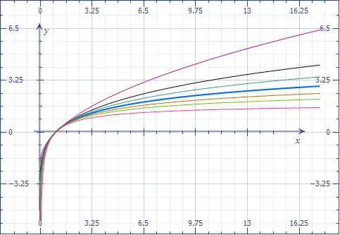

The paradox disappears when you consider the antiderivatives having the common point $(1,0)$, i.e. the functions
$$\int_1^x t^{\alpha-1}dt=\frac{x^\alpha-1}\alpha,$$
which are plotted below for exponents $-\dfrac12,-\dfrac14,-\dfrac18,0,\dfrac18,\dfrac14,\dfrac12$.
The blue curve corresponds to $\alpha=0$ but is evaluated as the limit
$$\lim_{\alpha\to0}\frac{x^\alpha-1}\alpha=\ln(x).$$
It perfectly blends with the others.
  • Thanks. Yes I see. I guess we just say "log" is the transcendental function denoting the limit of that function. – Shuheng Zheng Feb 23 '17 at 21:35
  • @JohnZheng: yep. Maybe in that sense it shouldn't be called transcendental anymore (or the non-integer powers should be). –  Feb 24 '17 at 08:04

  • @TorstenSchoeneberg: for any finite $x$, the function in terms of $\alpha$ is perfectly continuous and smooth. –  Jun 08 '18 at 06:21
  • I did not doubt that. Just saying that the one thing which is not clearly visible in this graph is that some of the functions have horizontal asymptotes, while others don't; and some of the functions intersect the $y$-axis, while others don't. To put it yet another way, on $(0, \infty)$ the functions have range $(-1/\alpha, \infty)$ for $\alpha>0$, $(-\infty, -1/\alpha)$ for $\alpha<0$, and $(-\infty, \infty)$ for $\alpha=0$. – Torsten Schoeneberg Jun 08 '18 at 16:36
  • @TorstenSchoeneberg: the doesn't "break the pattern". The $f(x,\alpha)$ is a smooth surface. –  Jun 08 '18 at 16:53
  • "Break in a pattern" is of course subjective, and I do think that your answer beautifully shows that this one is just a part of a larger smooth pattern. Still, for which $x\in \Bbb R$ is your first equation valid? The answer will include $x=0$ only for $\alpha>0$. Or in other words, we can very well focus on $f(x,\alpha)$ on $(0,\infty)\times \Bbb R$, where it's perfectly smooth. And I just add that e.g. it can be extended to $([0,\infty) \times (0,\infty)) \cup ((0,\infty) \times (-\infty,\infty])$. – Torsten Schoeneberg Jun 10 '18 at 19:51
  • This "boundary condition" is re-emphasized by the inequalities $$\frac{x^{-\varepsilon}-1}{-\varepsilon}\leq\ln x\leq\frac{x^\varepsilon-1}{\varepsilon}$$ which hold for all positive real $x$ and $\varepsilon$. –  Jan 10 '19 at 06:28
