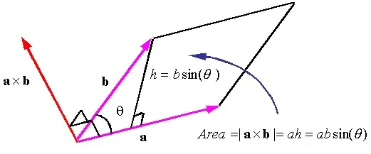

As stated in the picture the area of parallelogram is $||\vec a\times \vec b||=ab\ sin(\theta)$.
If we set $x$ the distance between $O$ and the intersection point of altitude h with $\vec a$ then $x=(\vec a\ .\vec b)/a$ as a projection of $\vec b$ on $\vec a$ (well in the drawing, considering the segments representing the vectors).
In this rectangle triangle we have $\displaystyle{cos(\theta)=\frac{adjacent\ side}{hypothenuse}=\frac xb}$
Pythagora's theorem : $x^2+h^2=b^2\iff\frac{(\vec a\,.\vec b)^2}{a^2}+\frac{||\vec a\times\vec b||}{a^2}=b^2.$
