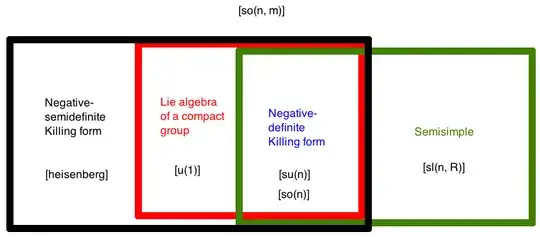

Edit: As levap points out, there are two inequivalent definitions of "compact," which correspond to the red zone and the intersection of the red and green zones of the following Euler map: enter image description here

There are two common but inequivalent definitions of a compact lie algebra: A compact lie algebra can either mean a lie algebra of a compact lie group or a lie algebra whose killing form is negative definite (see here for a comparison of the definitions). I'll assume you work with the first definition (and then the killing form of a compact lie algebra is negative semidefinite).

  • Just so I understand: your second definition of "compact" automatically implies semisimple, but your first does not? – tparker Feb 23 '17 at 08:12
    @tparker: Yeah. – levap Feb 23 '17 at 08:15
  • One last question, then I promise I'll stop bugging you: do you know of an example of a semisimple Lie algebra with negative-semidefinite Killing form which is not the Lie algebra of any compact group? I've edited my question to explain why I ask. – tparker Feb 23 '17 at 10:23
    @tpaker: This is not possible. If the Lie algebra is semisimple, the killing form must be non-degenerate and if it is also negative semi-definite, it will be negative definite and then it will be a Lie algebra of some compact Lie group. – levap Feb 23 '17 at 15:22
  • Just to fill in the steps of the proof that a nondegenerate negative-semidefinite symmetric bilinear form must be negative definite, for the sake of future readers: consider the contrapositive statement that a negative-semidefinite, not negative-definite symmetric bilinear form must be degenerate. There exists a $v$ such that $(v, v) = 0$, and for any $x$, $$ (v, v - x) \leq 0 \implies (v, v) \leq (v, x) \leq 0 \implies 0 \leq (v, x) \leq 0 \implies (v, x) = 0,$$ so the form is degenerate. – tparker Feb 23 '17 at 22:12
  • Great, thanks. I've updated the question with what I think is a correct Euler map showing the various relations, please let me know if I made a mistake. – tparker Feb 23 '17 at 22:33
