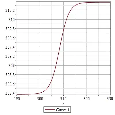

based on the comment below , the mapping function $$f(t) = a+{(b-a) \left( 1+{{\rm e}^{-{\frac {t-a}{b-a}}}} \right) ^{-1}}$$
can be used, here, with $a=308.36982554421727540$ and $b=310.36982554421727540$
the inverse function is
$${\it invf} \left( t \right) =a\ln \left( -{\frac {b-t}{-t+a}} \right) -\ln \left( -{\frac {b-t}{-t+a}} \right) b+a$$
and the function I am trying to find the roots of, the Hardy Z function in this case, is
where the root of the modified function isn't even found in the interval.. it seems that I need the mapping function $f(t)$ to map to a and b much faster than it is, since indeed the root is there, but not in the interval. If I go ahead and find that root and invert the mapping, thats not the root either.
The function Z(f(t)) has its root at 312.16854074213271881 so it cannot be inverted to a real number since it lies outside the interval, it evaluates to 309.86500608950761935-6.28318530717958647*I

You know that the root $x$ you are looking for is such that $a<x<b$ and your solver is not able to handle bounds.
What you can do is to define $$x=a+\frac{b-a}{1+e^{-t}}$$ which then gives an infinite domain for $t$.
Start Newton at $t=0$ which corresponds to $x=\frac{a+b}2$.
  • Interesting, a slight modification which I need, is to use the transformation
    $$a+{(b-a) \left( 1+{{\rm e}^{-{\frac {t-a}{b-a}}}} \right) ^{-1}}$$
    which has the limit as t=-inf being equal to a and as t->inf being equal to b .. once a zero is found then it can be inverted with $a\ln \left( -{\frac {b-y}{a-y}} \right) -\ln \left( -{\frac {b-y}{a- y}} \right) b+a$
    does that seem correct?
    – crow Feb 17 '17 at 16:35
