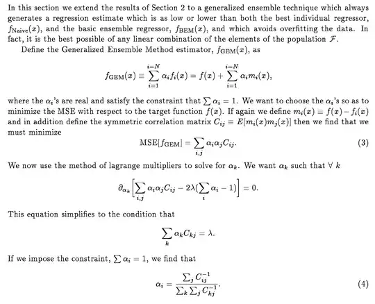

The problem to solve is
$\min_x \sum_i \sum_j C_{ij} x_i x_j$ $\,$ s.t. $\sum_i x_i = 1$.
for $C$ a symmetric and positive semidefinite matrix. Or equivalently
$\min_x x'Cx$ $\,$ s.t. $x'e = 1$.
This feels similar to a quadratic minimization onto the positive simplex (for a particular norm induced by C), although here the individual $x_i$ might take negative values. As already stated in How can I minimize a quadratic on the unit simplex? such problem can be solved with general quadratic programming methods, which also applies here. However, it seems that for this particular case a closed form solution can be found as
$x_i = \frac{\sum_j C_{ij}^{-1}}{\sum_k \sum_j C_{kj}^{-1}}$,
as stated (without proof) in the paper "When Networks Disagree: Ensemble Methods for Hybrid Neural Networks", section 4: http://citeseerx.ist.psu.edu/viewdoc/summary?doi=10.1.1.32.3857
How can this result be obtained?
And furthermore, would still be possible to find a closed form solution if positivity constraints are enforced as $x \geq 0$, recovering the positive simplex problem but for a pure symmetric quadratic objective?
