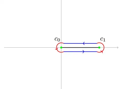

Consider the contour
enter image description here Consider the integral
$$\int_{c_0}f(z)\,dz+\int_{c_1}f(z)\,dz+\int^{1-\epsilon}_{\epsilon} e^{\frac{1}{2}\log|x-x^2|}\,dx-\int^{1-\epsilon}_{\epsilon} e^{\frac{1}{2}\log|x-x^2| +\pi i}\,dx = 2\pi i \mathrm{Res}(f,\infty)$$

$$\int_{c_0}f(z)\,dz+\int_{c_1}f(z)\,dz+2\int^{1-\epsilon}_{\epsilon} \sqrt{x}\sqrt{1-x}\,dx = \frac{\pi}{4}$$
Considering integrals the contours around $c_0$ and $c_1$ go to zero . Finally we get
