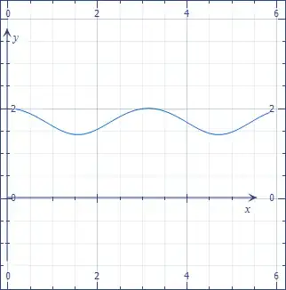

The two points are revolving on circles in the $xy$ and $yz$ planes, in a synchronized way, on the trajectories
$$x=\sin t,y=\cos t,z=0$$ and $$x=0,y=-\cos t,z=\sin t.$$
The phases are such that the points are on opposite locations on the $y$ axis at $t=0$.
The distance is thus
$$\sqrt{\sin^2t+4\cos^2t+\sin^2t}=\sqrt{2(1+\cos^2t)}.$$
It is maximum on every half-turn (from the position at $t=0$), forming a straight line with the center, and minimum every quarter turn later, forming a right angle.
The ratio of the long distance over the short one is $\sqrt2$.
