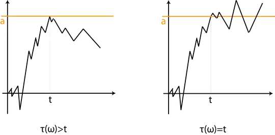

If we interpret $\mathcal{F}_t$ as "information up to time $t$", it's not surprising that the hitting time of an open interval $(a,b)$ is not an $\mathcal{F}_t$-stopping time. For instance if $B_t(\omega)=a$ for some $t>0$, then the information about the past, i.e. $(B_s(\omega))_{s \leq t}$, is not enough to decide whether $\tau(\omega)=t$; we need a small glimpse into the future. enter image description here
Making this intuition rigorous is, however, not easy. One possibility is to apply Galmarino's test which states that a mapping $\tau: \Omega \to [0,\infty]$ is a stopping time (with respect to $(\mathcal{F}_t)_{t \geq 0}$) if and only if $$\tau(\omega)=t, B_s(\omega) = B_s(\omega') \, \, \text{for all $s \leq t$} \implies \tau(\omega')=t, \tag{1}$$ see this question. If $\tau$ is the hitting time of an open interval $(1)$ is not satisfied; the easiest way to see this is to consider the canonical Brownian motion, i.e. consider $(B_t)_{t \geq 0}$ as a process on the space of continuous mappings.
