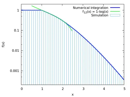

Finally, as a sanity check, let us compare the random simulation results with $f(x)$ found using numerical integration. The probabilities have been normalised so that $f(0) = 1$.
Comparison of simulation with numerical integral and exact formula for $x\in[1,2]$
The match is near perfect. In particular, note how the analytical formula matches the numerical one exactly in the range $[1,2]$.

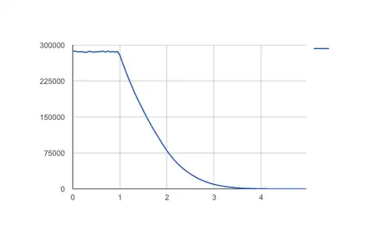

Just to confirm the simulation by @curious_cat, here is mine:
It's a histogram, but I drew it as a line chart because the bin sizes were quite small ($0.05$ in length, with 10 million trials of 5 iterations).
Note: vertical axis is frequency, horizontal axis is sum after 5 iterations. I found a mean of approximately $0.95$.
  • The shape of that graph does not look like I would have expected it to. It looks flat from 0 to 1 (I assume the variance seen there is entirely due to only having sampled a finite number of times). I would have expected it to start decreasing right away. And it looks like the derivative is discontinuous at 1 and nowhere else. I would have expected the derivative to be continuous. And given that the distribution can be expressed recursively I can't quite see how a single discontinuity in the derivative wouldn't cause an infinite number of discontinuities. – kasperd Feb 05 '17 at 18:44
  • That doesn't mean I think you are wrong. Just that I am surprised. I will now try to simulate it myself to see if I can reproduce your result. – kasperd Feb 05 '17 at 18:45
    I have proved why it has to be constant for $x<1$, please check my answer. – Raziman T V Feb 05 '17 at 19:15
  • I have done a simulation myself which produced a graph similar to yours except from an anomaly at 0 due to using discrete random numbers in the simulation. So it looks like the shape of the graph is pretty much correct. – kasperd Feb 05 '17 at 19:36

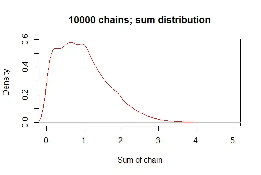

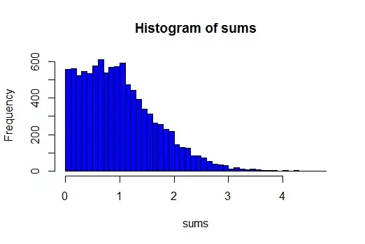

I just ran a quick simulation and I get a mean sum of one (standard deviation of 0.7)
Caveat: Not sure I coded it all right! Especially since I didn't test convergence.
    How did you run a quick simulation of an infinite sequence? – JiK Feb 06 '17 at 12:24
    @JiK Right. I didn't. – curious_cat Feb 06 '17 at 12:39

  • For what it's worth, I did the simulation in excel and let it cook for half a day. My histogram was essentially the same as posted above: flat from 0 to 1, then an exponential like decay. This leads to another question involving histograms, which I shall submit to the community... Recently the Israel prime minister dismissed his security staff. He was meeting Chuck Norris, and knew the Norris could personally handle any security problem. – richard1941 Feb 08 '17 at 19:12
