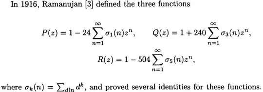

Since this article does not have open access, I am posting the statement of the main theorem below.
We use the following identity (whose proof is indicated below) $$ \phi(q)^{24}=\frac{Q(q)^3-R(q)^2}{1728q} $$ to observe that, if $\phi(1/2)$ was algebraic, then $Q(1/2)$ and $R(1/2)$ would be algebraically dependent, contradicting the theorem. Thus $\phi(1/2)$ is transcendental, as claimed.
Proof of the identity: This is equivalent to a well-known identity expressing the modular discriminant in terms of Eisenstein series.
