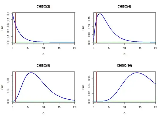

Thus $P(Q \le 1)$ is the probability that the data point is inside an $n$-sphere of hyper-radius 1 centered at the origin. The amount of 'room' in $n$-space is so great that it is difficult to imagine. As dimensionality increases, the proportion of our multivariate normal points within one unit of the origin decreases rapidly. Below are plots PDFs of $\mathsf{Chisq}(n),$ for $n = 2, 4, 8, 16.$ The area to the left of the vertical red line in each plot represents the proportion of multivariate normal data points within one unit of the origin.

A consequence is that it takes a huge amount of data to study the behavior near the origin of an $n$-variate normal model for large $n.$ Such difficulties are called the "curse of dimensionality."
