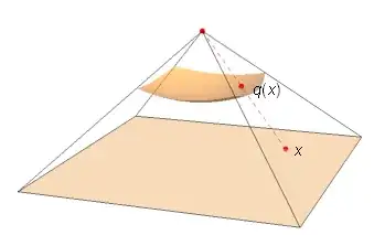

  • Consider the cube $\mathcal{C} = [-1, 1]^n$ and define $\mathcal{D} = \{x \in \mathcal{C} : |x| < \operatorname{dist}(x, \partial \mathcal{C}) \}$. Then for each point $x \in \partial\mathcal{C}$, we can find the unique point $q(x) \in \partial\mathcal{D}$ that lies on the line segment joining $0$ and $x$.
    $\hspace{7.5em}$ Point $q(x)$
    Using this, define $r(x)$ as the ratio
    $$ r(x) = \frac{\text{[length of the line segment from $0$ to $q(x)$]}}{\text{[length of line segment from $0$ to $x$]}} = \frac{|q(x)|}{|x|}. $$

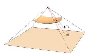

  • Let me first give a geometric argument. Let $d\mathcal{S}$ be an infinitesimally small portion of the surface $\partial\mathcal{C}$ near $x$ and consider the cone $d\mathcal{V}$ with the base $d\mathcal{S}$ and the vertex $0$.
    $\hspace{7.5em}$ Infinitesimal cone $d\mathcal{V}$
    Then roughly speaking, the portion of $d\mathcal{V}$ that intersects $\mathcal{D}$ is similar to the cone $d\mathcal{V}$ with ratio $r(x)$. Thus their volume roughly satisfies
    $$ |\mathcal{D} \cap d\mathcal{V}| \approx r(x)^n |d\mathcal{V}| = r(x)^n \cdot \frac{1}{n}|d\mathcal{S}|. $$
    From this, we have
    $$ p(n) = \frac{|\mathcal{D}|}{|\mathcal{C}|} = \frac{\int |\mathcal{D} \cap d\mathcal{V}|}{\int |d\mathcal{V}|} = \frac{\int_{\partial \mathcal{C}} r(x)^n \frac{1}{n} \, dA}{\int_{\partial \mathcal{C}} \frac{1}{n} \, dA}. \tag{*} $$
