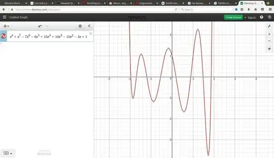

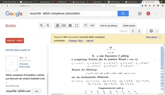

The more natural item is $$ 2 \cos \left( \frac{2 \pi}{17} \right), $$ which is one root of $$ x^8 + x^7 - 7 x^6 - 6 x^5 + 15 x^4 + 10 x^3 - 10 x^2 - 4 x + 1, $$ from page 18 of Reuschle (1875) using a method due to Gauss, having to do with cyclotomy, and predating Galois. If $\omega \neq 1$ but $\omega^{17} = 1,$ it is not hard to show that $\omega + \frac{1}{\omega}$ is a root of the given polynomial, using $$ \small 1 + \omega + \omega^2 + \omega^3 + \omega^4 + \omega^5 + \omega^6 + \omega^7 + \omega^8 + \omega^9 + \omega^{10} + \omega^{11} + \omega^{12} + \omega^{13} + \omega^{14} + \omega^{15} + \omega^{16} =0 $$
