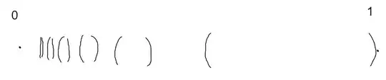

Just because the open intervals approach a number, doesn't mean the number is the endpoint of one of the intervals. Consider:
$$D_1= \bigcup\limits_{\substack{n~\in~\mathbb{N},~n~\text{odd} \\}} \left(\frac{1}{n+1}, \frac{1}{n}\right). $$
This looks like:

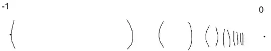

Next, let
$$D_2= \bigcup\limits_{\substack{n~\in~\mathbb{N},~n~\text{odd} \\}} \left(\frac{-1}{n}, \frac{-1}{n+1}\right). $$
This looks like:
Now let $D = D_1 \cup D_2.\ $ Then $0 \in D^c\ $ and $0$ is a limit point of $D^c$. But $0$ is not the end-point of any of the intervals in $D$. The same goes for members of the Cantor set- most members of the Cantor set, it turns out.
Just because the intervals "close in" on $0\ $ doesn't make $0$ an endpoint of one of the intervals.
