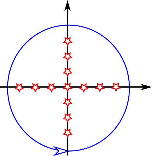

The key idea here is simple: Look for a function in the complex plane $f(z)$ which has poles at the correct values $z_n$ and integrate it over an appropriate contour $C$.
It turns out that the function (which is also the simplest guess i can imagine)
$$ f(z)=\frac{1}{z \cos(z)\cosh(z)} $$
is the correct choice. Its poles are given by $z_0=0$, $z_k=\frac{(2 k-1)\pi}{2} $ and $\tilde{z}_k=i \frac{(2 k-1)\pi}{2} $ with $k \in \mathbb{Z/0}$. We furthermore have
$$ \text{res}(z_0)=1 \\ \text{res}(z_k)=\text{res}(\tilde{z}_k)=\frac{2}{\pi}\frac{(-1)^{k}}{(2k-1)\cosh\left(\pi\frac{2k-1}{2}\right)}\\ \text{res}(z_{-k})=\text{res}(z_k) $$
since $z\cos(z)\cosh(z)\sim |z| e^{a |z|}$ with $\Re(a)>0$ as $|z|\rightarrow\infty$ we can choose a big circle traversed anticlockwise with radius choosen such that we hit no pole of $f(z)$ as the integration contour $C$ (Thanks to @Dr. MV for rigorizing this point).
Then, we get by applying the residue theorem, we get in the limit of infinte radius
$$ \oint_Cf(z)dz=2\pi i\text{res}(z_0)+4\pi i \sum_{k\geq1}\text{res}(z_k)+4\pi i\sum_{k\geq1}\text{res}(\tilde{z}_k)=0 $$
or
$$ 8\pi i \sum_{k\geq1}\text{res}(z_k)=-2\pi i $$
which can be rewritten as (after shifting $k\rightarrow k+1$)
$$ \sum_{k\geq0}\frac{2}{\pi}\frac{(-1)^{k}}{(2k+1)\cosh\left(\pi\frac{2k+1}{2}\right)}=\frac{1}{4}\\ \textbf{Q.E.D.} $$
To make things clearer, here is a sketch of the integration contour $\color{blue}{C}$ and the singularities $\color{red}{z_n}$
