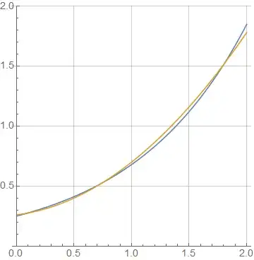

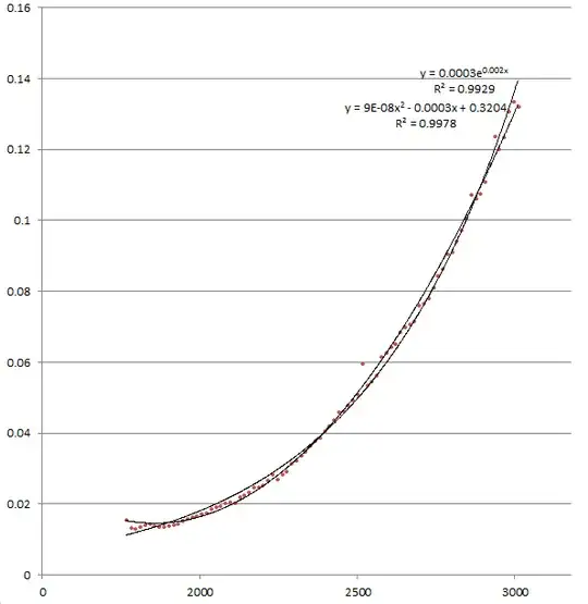

You can't. No, not just "in theory", but also in practice.
I tried this when doing regression before and I gave up on it once I realized how impossible it is:
Curve
(Ignore the left upwards part of the parabola; pretend you don't have that piece of information when you're trying to tell which is which.)

Since I couldn't reproduce the plot above anymore (I only kept the screenshot, and I'm not sure why the formulas don't seem to be reproducing it), I'll include an artificial one that illustrates the same problem:
Plot 2
To reproduce:
Plot[{Exp[x] / 4, 0.32 x^2 + 0.12 x + 0.26}, {x, 0, 2}, PlotRange -> {Automatic, {0, 2}},
    GridLines -> Automatic, AspectRatio -> 1, BaseStyle -> {FontSize -> 14}]
user541686
  • 14,298
    This looks an awful lot like what my economics professor called the curse of exponentiality (which as he used it referred to the fact that you can't really tell whether a curve (e.g. US debt) is exponential or something like parabolic until it's too late to do anything about it; when I did a google to make sure I had the right term, it looks like it usually is taken to refer to something slightly different), but the main point being: you might be able to determine better if you extend the curve out further – Foon Jan 12 '17 at 21:10
  • @Foon: It very well may have been (though the only such "curse" I've heard about is that of "dimensionality" rather than "exponentiality"). It's worth pointing out though that the nice thing is nothing in real life can grow exponentially for very long; if you're observing something physical, it's likely to be e.g. logistic instead. What I was doing regression on was the complexity of an algorithm, which can happily grow exponentially. :-) If I remember correctly I couldn't grow it to the right since I didn't have the time to wait for it to finish with very large inputs... – user541686 Jan 12 '17 at 21:16
  • You only can't tell between quadratic and exponential in that example because the parameter is varied over just a small range, so mostly you see only two Taylor terms of the exponential anyway. If the parameter reached twice as far, in either direction, then it would be much clearer what's going on. – leftaroundabout Jan 12 '17 at 21:32
  • @leftaroundabout: I think it's safe to assume the OP isn't asking about the cases where it's obvious which is which... because those cases are obvious. – user541686 Jan 12 '17 at 21:35
  • The question seems to be about fairly precisely drawn curves rather than dirty data or approximations, so I think this does not answer it. On the other hand it does answer a different interesting question! – PJTraill Jan 12 '17 at 21:37
  • @PJTraill: You missed the point of the answer. Ignore the data points and just look at the curves. And read the note on the bottom. – user541686 Jan 12 '17 at 21:39
  • Addendum: I can't reproduce this at the moment... it seems Excel might have omitted the y-offset in the formula for the exponential for some reason? Let me see if I can find out what it was. (I took the screenshot when I produced the data, and I don't have the data anymore and just took the formulas for granted.) – user541686 Jan 12 '17 at 21:43
  • @Foon, you also can never tell if it's an exponential, or a sigmoid that just hasn't hit its inflection point yet. – Mark Jan 12 '17 at 22:15
  • The problem is that any function with a continuous first derivative looks arbitrarily close to a line on a sufficiently small scale. Thus, I believe the original question (that claimed that you can tell whether a curve is a line or a parabola) meant "can you tell if a curve is an exponential, if you have its representation on a sufficiently large scale?" – Anonymous Jan 13 '17 at 04:33
  • @Anonymous: If I asked you whether you can tell a 9th degree polynomial from an 7th degree polynomial, would you say "yes" because "on a sufficiently large scale" the difference would be obvious? I'm sorry, but the answer is obviously no. When it's so obvious then you wouldn't be asking the question in the first place. When it's not obvious then you wonder if there's some kind of trick to help you, and the answer is no, unless the kind of trick you're talking about involves doing math on a computer or paper. And notice the scales here aren't so ridiculously small either. They're realistic! – user541686 Jan 13 '17 at 07:47
  • @Mehrdad Note that it's very different recognizing if a curve is an exponential, and distinguishing that curve from a specific parabola. The latter (which is what you seem to be focusing on, as far as I can tell) is indeed trivial by observation if you can "zoom" in and out at will. The former is not so easy, if you have to eyeball the curve without doing quantitative calculations, fitting to other curves, etc. - which is what I believe the original question asked. – Anonymous Jan 13 '17 at 08:04
  • @Anonymous: First you tell me the question is asking about a curve whose representation you have on a "sufficiently large scale", now you tell me the question is assuming you can't zoom out? If you have it on a large scale then that means you've already zoomed out. Make up your mind as to what the question is, I don't even get where you're going with this anymore... it just seems like your only goal is to somehow contradict me here. :\ Like I said, if it's obvious then you have no need to be asking this question. If it's not obvious then I'm saying you probably won't be able to eyeball it. – user541686 Jan 13 '17 at 08:11
  • @Mehrdad contradicting you is definitely not my goal, and to prove it, I'll just abandon the discussion after this comment. I believe there have been some misunderstandings, and I was trying to clear them up, apparently without success. Note that the issue here is not telling a specific curve x of type A apart from a specific curve y of type B, but telling wether a specific curve x is indeed of type A. They are subtly different issues, I believe, and the difference has a number of implications; but if I have not managed to make myself clear so far, I'll just give up! – Anonymous Jan 13 '17 at 08:20
