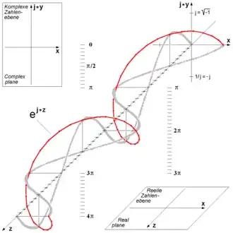

If you'd like a more intuitive explanation, here is an image from Wikipedia:
To answer your question about $i$ represents, $i=\sqrt{-1}$. It is an imaginary number.
As you can see from the diagram, the angle $\varphi$ represents the angle going from the real axis on an Argand Diagram going counter-clockwise.
Basically, in mathematics you have several systems for angles. There is the conventional degrees ($^\circ$), and radians ($^r$). (There are others, however they are not useful at the moment).
$1$ radian is equivalent to $\frac{180}{\pi}$ degrees.
Therefore, a full $180^{\circ}$ degree turn is $\varphi=\pi$ radians.
The equation on the image, $e^{i\varphi}=\cos{\varphi}+i\sin{\varphi}$ (Euler's formula) uses radians for angles of $\varphi$.
If you rotate the angle $180$ degrees, or $\pi$ radians, you will notice that the arrow will point towards the left hand side of the unit circle, towards the point $(-1,0i)$. This is why $e^{i\pi}=-1$. You can also just simply substitute $\varphi=\pi$ into Euler's formula, then you'd get the same identity.

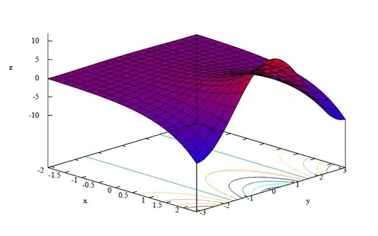

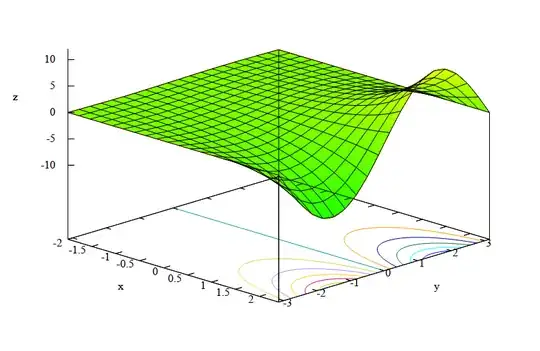

And so this is the exponential function cut in half. The first is the real part and the second is the imaginary.
Notice how as they go right, they start to behave more and more exponentially. But at the same time, in the other direction, they behave like a wave, going up and down.
